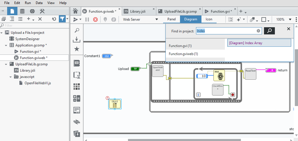

Sure, happy to help. You can also search for functions, nodes, etc with this. In the below image, I searched for Index Array by typing index, which finds two results in two VIs.
The LabVIEW NXG help documentation is the online Product Manual. The online help is very searchable, and you can start there for basic info. Feel free to point out anything that is missing or that would be helpful to add.

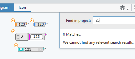

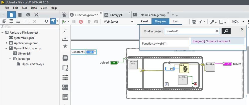

Are there any options for the first query (searching numeric / path constants)? The search also doesn't seem work for string constants inside an array.

@fblerg wrote:
There isn't options for Ctrl + F search. I will file a bug report for the inconsistent behavior for string arrays and numerics. Thanks for pointing that out.
I tested little more. Seems no value is searchable. For example, path constants cannot be found.
By the way, learning language starting from keyboard shortcuts was really fun and unusualSmiley Very Happy
