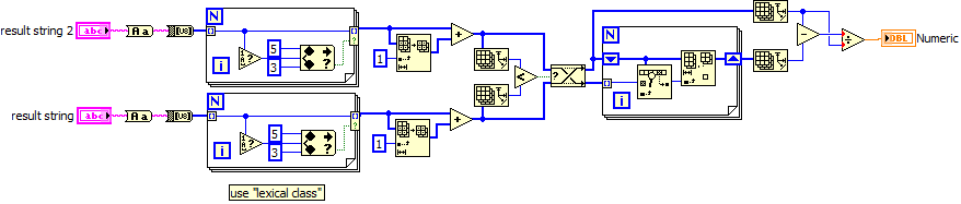

@Hooovahh wrote:
So I have some pretty terrible code ...
Just for kicks, here is a quick and rough draft of a near literal translation that uses more modern tools (lexical class, swap values, conditional tunnels, etc) and is mostly blue....
Seems to give the same results if you convert all to lowercase in your inputs. Not sure how sound the algorithm is 😄
Message 7 of 11
(4,634 Views)
Thank you and kudo'd.  Yeah this technique mostly is about a letter, following an expected letter.  So if my name is Brian, and someone spells it Brain, it will find the 'r' following 'b', and that's it, 'a' shouldn't come after 'r', 'i' shouldn't come after 'a', and 'n' shouldn't come after 'i'.  This would result in a pretty poor score of 0.3 and all that you have is one letter swapped.  Now that I look at it this is a pretty bad way of doing things and someone should come up with a better technique.  Maybe add the number of each letter to be seen?  Or maybe look at the letters that are wrong and see if they are close to the correct key on the keyboard?  Then you might also need a list of commonly misspelled words.
