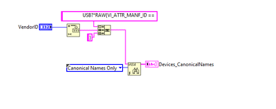

Thank you so much for the responses. I have used the following method and that worked!!
Pratyusha.
