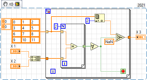

@GG00 wrote:
Hi! I am trying to code a program that takes a truth table as an input then searches each row for a specified input signal combination.
For examle if I search for the combination x1=1, x2=0, x3=1 then this program should find a matching row then print the output that this row produces. The output is also specified in a table.
This makes very little sense to me as a "truth table" sets out the functional values of logical expressions. The output of a truth table is dependent on the logic the truth table is showing.
So lets stop calling it a "truth table" and just call it an array.
DO you want to search a 2D array row by row to match the first two elements, then return the third element in the matching row?
How about something like this?
Match not found returns NaN (Not a Number)
