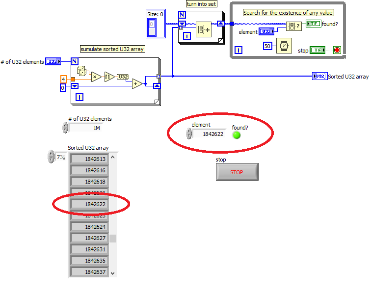

@altenbach wrote:
Maybe you can turn it into a SET (LabVIEW 2019+, "collection" palette)?
Here's what I had in mind:
It will tell you if the value exists or not.
Note that if you are also interested in the original index of the element, you could use a MAP with the U32 value as key and the original index as value (not shown).

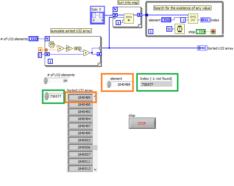

@altenbach wrote:
Note that if you are interested in the original index of the element, you could use a MAP with the U32 value as key and the original index as value (not shown).
Here's how that could look like:
Message 4 of 11
