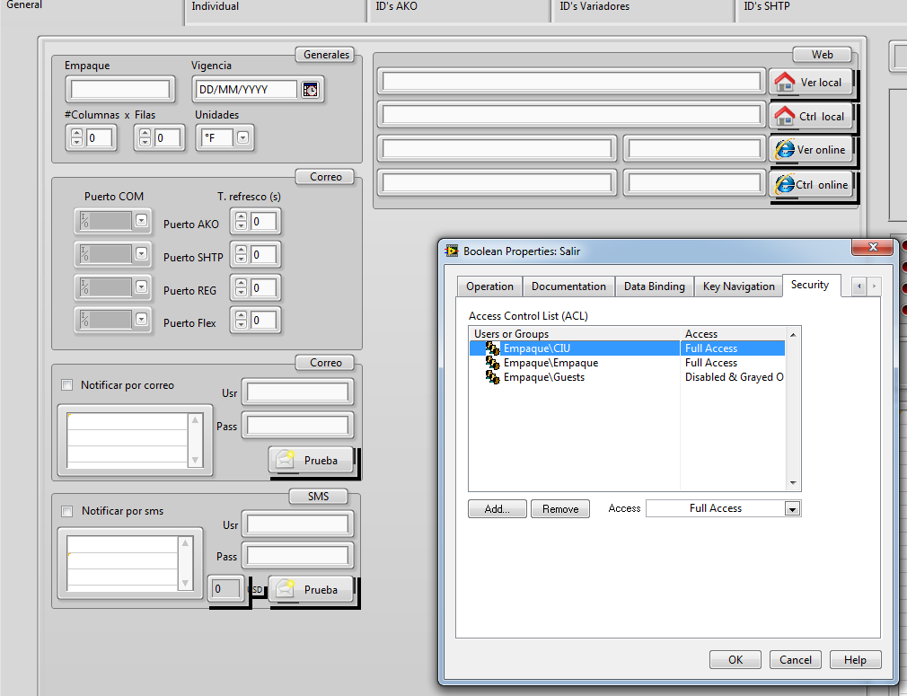

I've a VI wich implements secutity at some controls, disabling them for some users. It works ok even in the executable.
Security
But  when I open the Web page, created with the Web publishing tool, the user can access to all controls even when they're disabled in the VI.
 Is it a bug? I build the web page in the computer with the domain manager.

But in the VI the controls are disabled and grayed, they really are.

Hi, I mean, in my front panel, in the computer running the executable, the executable has the controls disabled.
But in the remote front panel they're enabled, so if somebody is manipulating the remote front panel, they can interact with the controls. Like in my picture
