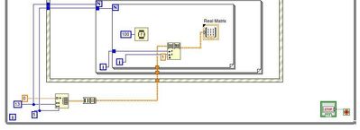

I have a matrix indicator OUTSIDE of an event structure, like so:
My problem is, that it shows the result of the for loops only, so the result of the last step.

You don't need any of the inner loops or local variables. Keep the matrix data in a shift registers. Then just keep track of the indices in one shift register (one counting through the total number of elements, using Q&R to get the row/column at each iteration) of the outer loop and increment the values and modify the array in the timeout case set for a 100ms timeout. Also keep the current timeout value in a shift register and Once all values have been shown, reset the timeout back to -1 (infinite). Decide what to do if an event is triggered while it is still processing a current event (e.g. ignore and finish the new scenario, do the new thing instead, etc.).
This also has many advantages because it does not trap the code inside lengthy events during which nothing else can be processed by the event structure.
