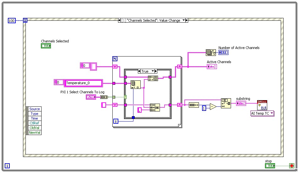

Thanks for the example.  For some reason I am still unable to wrap my mind around setting this up with daqmx.  I put together a quick vi that illustrates what I would like to accomplish and maybe someone could point me in the direction of accomplishing the same thing with daqmx.  On the UI I envisioned some sort of dialog pop-up where the user would select which channels to read from and log data, this is labeled as “PXI 1 Channels to Log.”  That would be followed by another dialog to select the channels to actually graph labeled, “PXI 1 Select Channels To Graph.”  Ultimately there will be over 150 thermocouples so I need to be able to select the channels and view up to 8 or so on a graph.

First, make the default values for your radio buttons off.  Let the user choose from the list.  Otherwise your array will be built with a bunch of channels upon the first radio button press.  Same for the other radio button structure.
Next, your second loop runs in parallel to the first.  It will start running as soon as the run button is pressed.  The local variables will be read before the user has a chance to choose channels.  This is not what you want.  Put a button on the front panel that the user must press when he is ready (after he has chosen the channels).  Put the second loop in the Value Change event for that button.  In fact, you don't need a loop.  You only need to write active channels to the file once.  Get rid of the loop.
Put a value on the timeout event (the hourglass).  This causes an event in case the user doesn't press anything.  You don't have to put any code in the timeout case.
Once you have your list of channels, you can create a comma separated string from the Active Channels array and feed that into the DAQmx Create Channels.  To create the string, wire the array into a For Loop with indexing enabled.  Use a shift register initialized with a blank string.  Concatenate the shift register with the indexed array value and a comma.  Feed the concat output to the shift register.  Upon exiting the loop, remove the last comma by using String Subset.
Do this part and we can tackle the rest later.

You were close.  But you made beginner mistakes.  You must put the event structure inside a while loop.  Otherwise the event structure will wait until an event occurs, then when one does, the program will end.  That is why you had to set the timeout value so large,  But that is not the way to do it.  Set the timeout value small and put the event structure inside a loop.  The timeout event will fire often, but the loop will stop the program from ending until a stop button is pressed.  See my code for an example.  You could also add an event for the Stop button value change.  In this case, you would send a boolean constant True to the stop sign.
You don't need the stacked sequence structure.  Stay away from those, they promote bad programming practices.  All of your code fit easily in one event case, as you can see below.  Instead of having two For Loops, I combined the code into one loop.  It builds your channel array and your channel string simultaneously.  Always put the control for an event inside the event case, as shown for the Channels Selected control.  This way, the program will read the control when the event fires.  If it is outside the case, as you had it previously, the program will read it once, at the beginnng of the code, and it will never be read again.  The event will fire, but the control value is never read again.  If the control is a latch type, by not being read, the latch release never occurs.
I have attached the vi in 8.6.
