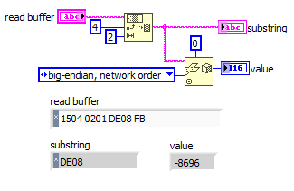

So, in your example picture (1504 0201 DE08 FB) which one is byte #4? (i.e. is the first byte #0 or #1, for example). Do you want "x01DE" or "xDE08"? Is this an signed or unsigned integer? What is the byte order?
Maybe play around with something similar to the following:

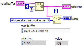

Hi Altenbach thanks for your help. The bytes I need are x01DE in that order. It is an unsigned integer because the sensor measures gas ppm and that value can only be 0 or positive. Does the method you've shown below work for both positive and negative numbers as long as I change the integer indicator type or another setting? Also, could you please list the functions by name that are shown in your screenshot? I'm very green when it comes to using LabVIEW, and I'm still finding my way around the functions and tools palettes. Thanks again
String position, file position, array indices are all zero based, so the first element is #0. To get x01DE, you need to get the string subset starting with 3 and size=2.
If you know it is an unsigned integer, you need to wire a U16 constant to the top of "unflatten from string". Just place any numeric diagram constant and "right-click...representation...u16".
(Note that I underlined the name of the only two functions used. find them and read their help.)
