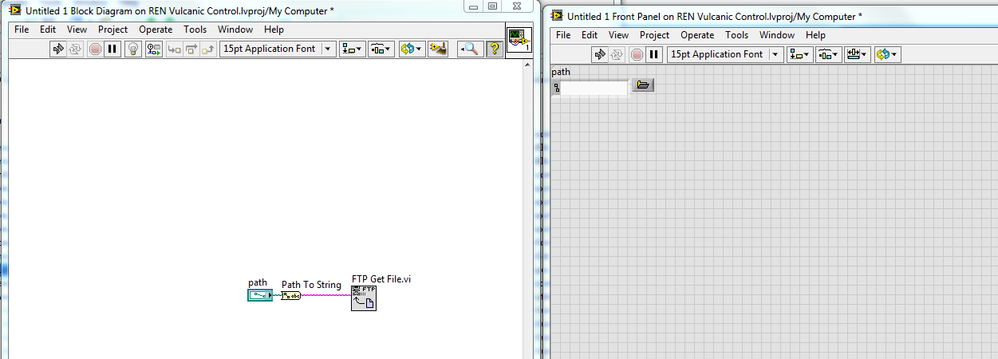

Hello Slaxx,
Have you tried the path to string function to convert a path to the string address that you want?
I don't know if it works or not.
(2,851 Views)
Hello HoussemeddineSnoussi
Thank you for your help. That was my idea first as well. But the problem is the Path Browser won't even let me select a file on the FTP-Drive.
