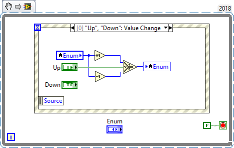

So it sounds like you want an enumerated list, but don't want them to be able to "open" it to select from the dropdown, is that right?
If so, I don't think there's a way to prevent the user from being able to click it to select the value in a list. Discarding all MouseDown events won't work either as that discards MouseDowns on the increment/decrement buttons. You *could* do some math to figure out if the MouseDown is on the button or on the increment/decrement buttons, but I generally stay away from that sort of thing as Windows magnification settings or font settings can be obnoxious to deal with.
You can disable the control (right click->advanced->enabled state->disabled, then hide the increment/decrement buttons (right click->visible items) and add some of your own buttons, handled in an event structure like so:
If you don't like the look of those buttons, you could use a regular numeric control for its increment/decrement buttons and hide the display behind the enum. You'd need to handle it slightly differently, but nothing too bad.

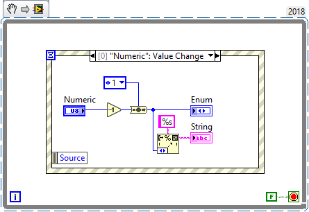

Ah, that's very easy then. Just connect your numeric control to an enum indicator- it'll auto-coerce just fine. Make sure your numeric control is an integer type though (I'd use a U8, but it won't matter). The indicator won't be clickable. If you want it to update in real time, put that in an event structure so it updates the enum when you increment the numeric.
Right click the Numeric to set its properties to give an allowable range of 1-35, and it'll stop when it gets to 35. If you want it to wrap around, you'll need to do manual checking in an event structure, otherwise it'll just stop at 35 and won't increment anymore.
Oh, and you'll need to add a -1 to the value in the selector, as the Enum will use the number of the item in its list. For example, if the first element in the enum is "1", then wiring a 0 to the Enum will make it display 1, as it's zero-indexed. Wiring a value of 1 to the enum will select the second item in the enum (again, as it's zero-indexed, it'll count 0, 1, 2, 3, etc.)

Yep, oddly enough, using Format Into String. You'll need to actually coerce the wire type to the type of the enum though instead of letting it auto-coerce (using Coerce to Type with an enum constant, preferably a typedef):
