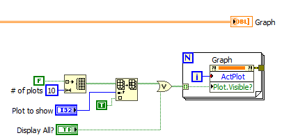

Here's what I had in mind earlier. This is a useful solution if you want all plots and each plot has it's unique color and style, but you only want to display one at a time. There is also a boolean to show all plot if desired. Modify as needed.

Is there a way to wrap this in a while loop such that every time you change the "Plot to show" control value, the graph changes ? Thanks! - John
(5,357 Views)
Yes, but you pretty much answered your own question.  Take the code in Altenbach's solution and draw a while loop around it.  You probably want to add a small (50ms) Wait.vi in the loop so it doesn't eat up CPU cycles.
A better way is to use an event structure in your loop that only fires when you change the "Plot to Show" control.
