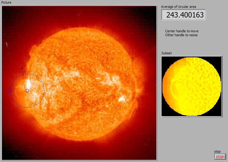

In the above you saw how to use plot images.
Here is a simple example to draw/resize/move a circular area using two handles. Should work equally well on an intensity graph instead of a picture. Simply make sure you transform the coordinates correctly.

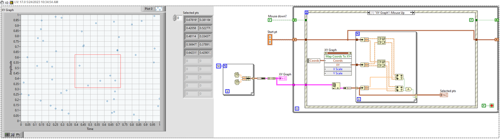

Here's a very quick and dirty example that doesn't use picture controls. Instead, it just draws a new plot on the plot to make a box. I'd assume something like this would work similarly for intensity plots but I'm not sure.
You'll definitely want to clean it up and encapsulate a lot of this in subVI's, but it's all in one VI just to clearly see what all is going on.
You'll also want to filter out "Mouse down" events that occur when the user is, for example, zooming in or something. You can see which tool is selected with the "Palette: Active Tool" property node and you can ignore zooms, etc.
I don't think you can shade an area inside a plot like this. For that, you would need a picture control, which is certainly the more powerful tool. I just find this method a little simpler since you never have to draw any pixels yourself.
Note: the VI you uploaded is in too new of a version for me to see, so it might use this stuff already. Apologies if so.
Second note: The multiple "Max and min" and "In range" functions should be condensed into a subVI. You can use "In Range and Coerce" on clusters directly, but that would likely introduce a dependency on the direction you drew the box. In other words, "bottom left to top right" would work normally, but "top right to bottom left" would swap your min and max values around and it wouldn't see any points. There is probably a VI that does this already but again... quick and dirty 😉

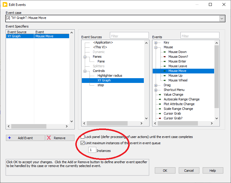

  • All move events should limit the event queue to 1. (picture)

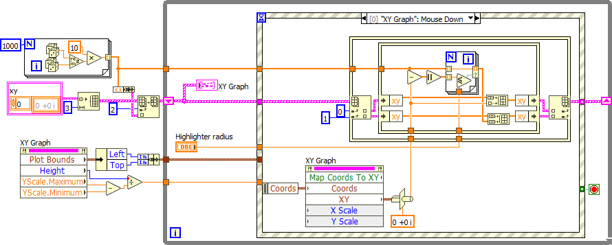

  • You only need to calculate the new points on mouse down, not 10x per second.
  • If you place the graph terminal before the event, you don't need a timeout event, but you need an event for the stop button.
See if this can give you some ideas....
Note that the "typecast to complex" only works if the cluster has exactly two DBL elements in the right order, so be careful!
