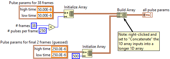

It isn't nearly as hard as you seem to think.  Here's how simple the code can be for creating the array of pulse parameters you need:
Start from the shipping example for continuous buffered counter output.  It's already configured to want pulse params in terms of high time / low time.  Just use the result above as the data to wire into DAQmx Write.
- Kevin P

Thanks for the help Kevin. I am unable to drag the image into my block diagram, so I am trying to recreate your code but having trouble recreating the pulse parameters. How can I setup the pulse parameters?
Message 7 of 8
(1,996 Views)
The pulse params are just a cluster containing 2 DBLs, high time first and low time second.  It would be pretty easy to build from scratch.
Another thing you could do is go to the buffered counter output shipping example.  First save it under a new name in a folder of your own before making any changes.  Then on the diagram, right-click the 'Output Array' terminal and choose "Create Constant".   Then right-click the new constant and choose "Change to Element".  That'll get you the same scalar cluster so you can build up your array of them.
-Kevin P
