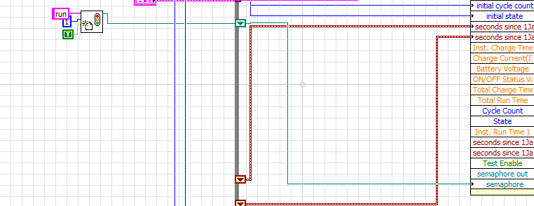

Here is a snapshot which encompasses the semaphore path where it fails.
Below shows the semaphore being created and passed into the sub VI. Probing the input of the sub VI shows teh semaphore reference.

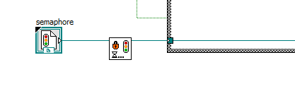

Below is the control that recieves the semaphore input in teh sub VI(clone). When probing the output of the control the signal becomes not a refnum.  There is nothing else touching the semaphore from creation to failure

I think if i understood correct:
-In first image you passed semaphore ref into a cluster.
-Second image you are passing from semaphore control to subvi.
Now, Where is the connection to the control from the cluster(semaphore ref is in cluster) which you passed?

udka,  the semaphore ref is passed into a sub vi. the second image is the semaphore being transfered from the sub vi's control (input) to the aquire semaphore vi.
After som digging around yesterday, the snippets that I posted do work. The error in troubleshooting was PEBCAC as I assumed teh problem was happening at the first sub vi. The sub vi is a reentrant clone and tehre are 16 of them that pass along the semaphore in the program. Somewhere way down in the list of them a wire became disconnected <oops>. The issue I had was that it was not obvious which sub vi block diagram was automatically  opened when the error occured and the program was stopped.

Hi uday,
I think the first picture is actually passing the semaphore into a VI with a LOT of inputs/outputs. It does look a lot like a cluster bundle, but it's just the VI with unchecked "View as icon"
