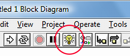

Yes, execution highlighting as below.....did it run? What was the result? If you get the same indications, you should have been able to see who last acquired the semaphore.

I said that my pictures were taken when I were turning the high light function. If you click zoom on the picture, you will see those waiting green arrows at my acquire semaphore VIs. You cannot see this if I didn't turn on the highlight function.

I suspect you're running and THEN turning highlighting on, which by then is too late to see what part of your code caused the problem. I would suggest you turn on highlighting before you start running. Then you should be able to step through your code and find where the issue is.
