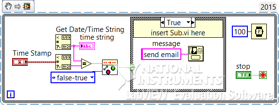

So for this dynmaic event I have a few questions.
The VI I'm working with is not of my own creation and there is a lot of stuff going on with it.
It seems like over the years they just keep adding to it without making it cleaner. It happens!
So there are 3 states (event structure) in this VI..
Start up-which bypasses alarms for 5 min then automatically goes to
RUN- which obviously has all alarms active,
and-Inspection mode. Which pauses everything.
So I'm assuming I can drop this dynamic event into the RUN event of the VI, so when the Inspection mode is active for example, no emails will send.... basically.
Is this correct?
Would it need it's own while loop as you show to contain all of it?
Thank you for your help and ideas.
