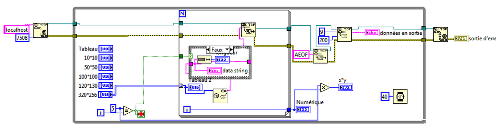

It is working !!!!
I separate my data to send only a row at the time, and now I have no more problem.
I add my VI and python code to this post in future people have the same issue.
Again thank you all for your help and discussion.
