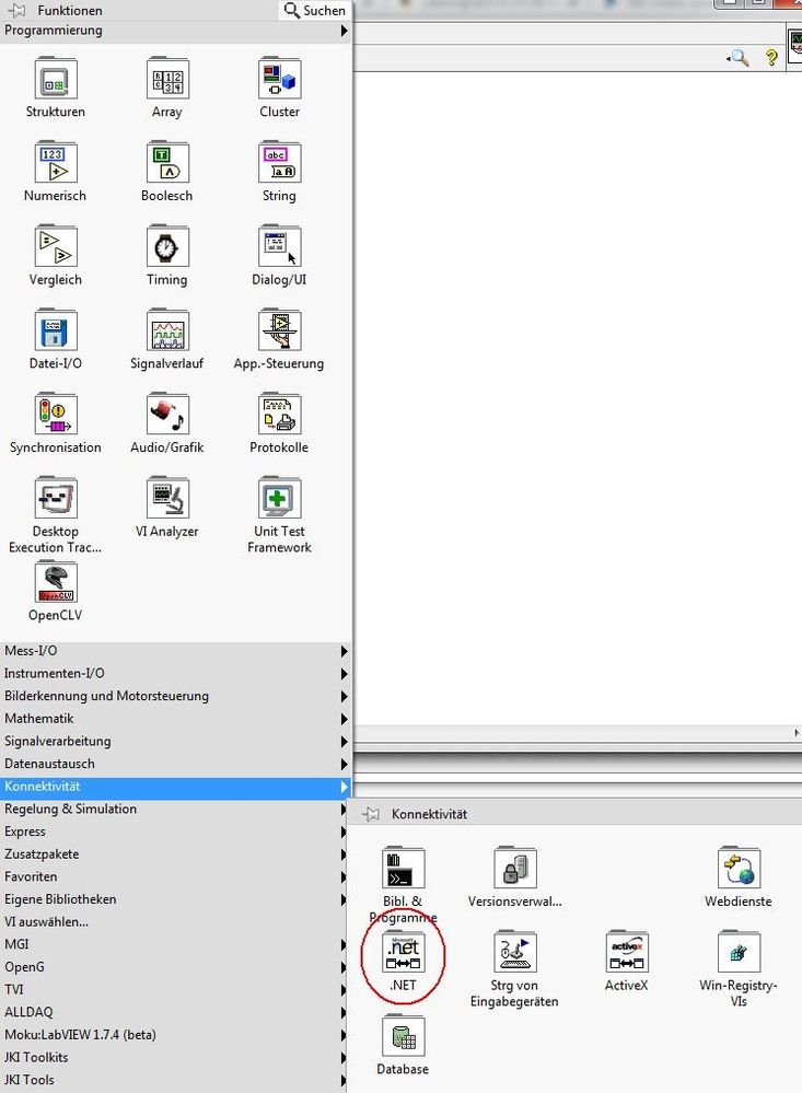

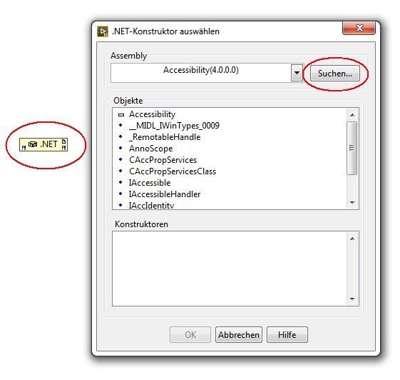

You have a C# project, so it is a .NET DLL.
With the Call Library Node you can only access C/C++ DLLs
You need the .NET Conctructor Node:
Eugen Wiebe
Bernstein AG
CLAD - Certified LabView Associate Developer
