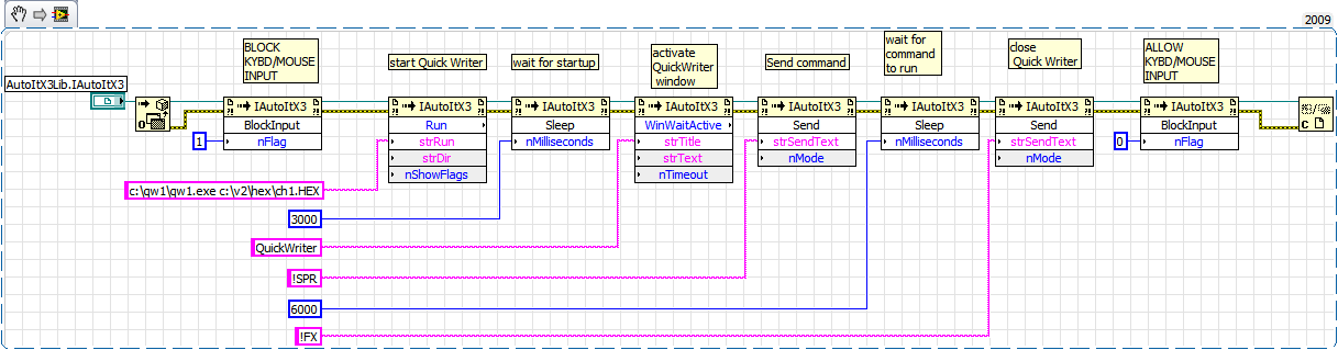

Check out AutoIT for controlling external apps
I've used it with great success to lockout the keyboard/mouse  then run the external code , then enable the keyboard and mouse again
see snippet below.  You create an Automation Refnum to use the AUTOIT library features
just google AUTOIT
Last I checked it was a free download

I use Auto IT  for everything -
lock keyboard / start external app / send commands / close external app / unlock keyboard
see below

I am researching auto it and found the following statement.
Note that functions such as WinMove() or Send() will still work when BlockInput is enabled because BlockInput just affects user interaction with the keyboard or the mouse not what is done with AutoIt functions (aside from the exceptions in the table above).
That means there is hope!  And from what you have posted too.  Using Labview user32.dll to block input then send keypresses won't work as far as I see since it blocks the keypresses I need to send too (when input is blocked).
Now I just need to figure out how to use Auotit!
THANKS ALL FOR YOU BIIIIIIIIIG HELPPPPPPPPPPPP!
