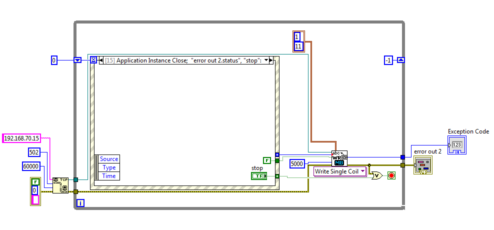

Sorry if this is such a rookie question but I've searched a lot and found no elegant solution to my problem.
I have a PLC with which I communicate via a VI (MB Ethernet Master Query Write Single Coil).
In an event structure, I have assigned each of my 15 relay on the PLC to open when I press the associated boolean.
In other word, when I activate the boolean on my front panel, it triggers an event that send the corresponding Modbus adress and the boolean value to the Modbus VI.
Now for my issue:
I want to create a protection that if there's an error, if the Main VI is stopped or if the window is accidentally closed, it will close all channels
But for the VI to do that, I need to send, in sequence, all the adresses (0-15) as well as a FALSE state for each of them.
And I'm just at lost on how to do that.
Thanks for any help

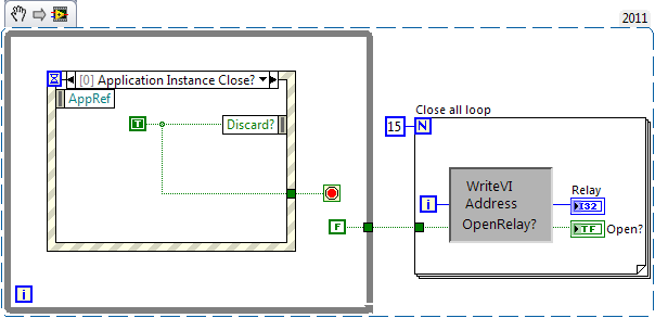

Put a for loop that will turn off all channels after main while loop.
To process application close I usually use Filter events (app -> instance close? or VI-> Front Panel Close?) and discard them. After a last action of VI I close the front panel (invoke node) if  needed. I am used to doing that because I am not completely sure event structure processes the frame "App Instance close" before really closing application. And it definitely does not process anything after this event.

In Tools - VI properties -> Appearance -> Customize you can Disable possibility to close window or you can discard it and process.
Application instance close? event happens, when you close project window, or, possibly when another vi calls StopLabview function. It will not help against task manager task abort or computer shut down.
Edit: it helps against shutdown: it processes event and loop when I press Windows Start button -> Shut down. Possibly if it takes longer than windows timeout, it will force destroy it.
I do not know how you make your address, if it is 0 - 14, see below - connect your Write Relay state vi instead of fake picture
 Edit 2: If WriteVI can be reentrant, you can parallelize closing loop so that all relay close at the same time, not one after one. I do not know how long each one takes, so it might or might not speed up closing all.
