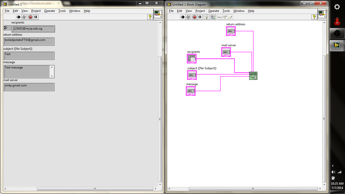

Hi, I'm a student new to the forums. I don't understand why this VI isn't working. I'm trying to send a mail from LabView2011 when a sensor detects motion. We got the sensor VI downI. I've searched the forums but I don't really understand what's going on.
When I pres run, even without a while loop, the program just keeps on running non stop. After 10mins nothing happened and I stopped it.

Did you see this very recent thread: http://forums.ni.com/t5/LabVIEW/SMTP-Email-Error-54/td-p/2909574
You can't use the email functions in 2011 for a server such as Gmail that requires authentication. Please see the other thread for alternatives.
