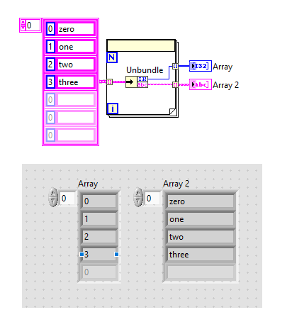

I have an array of 5 cluster elements. Each cluster has 1 string and 1 numeric. I have been trying to separate them into 2, one containing only the string values and the other only numeric values. It can be anything either an array or a cluster. How can I achieve this? I have been trying different methods with build array, insert into array etc. But none of them is giving me the final output that I require. Kindly do help me.

This may be what you need. Use a For Loop to unbundle your clusters and create the arrays.Array of Clusters to Array.png

Hi Govind,
This is a very basic use of for loops

I hope its very basic and many commented the solution, if you are new to LabVIEW please go through basic online LabVIEW Tutorial and Understand More about structure's and Loops.
