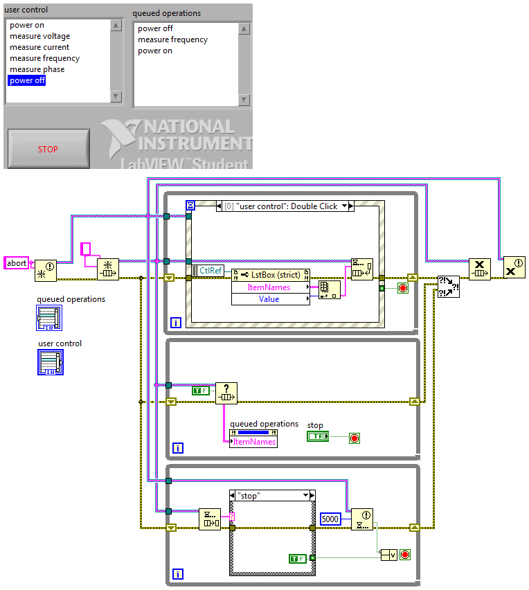

there are many different ways to skin a cat...this example is like the cld sprinkler solution and the last is the famous producer/consumer...TEST2.png
It would be helpful to attach actual example code instead of a code picture. It is not possible to recreate the programs from your image, because too many things are hidden in other cases.
Who wrote this code??? Just from a casual glance, there are some really questionable constructs, starting with the "equal TRUE" in the outer FOR loop of the upper picture. The lower code does not seem applicable to the problem, because the listbox selection mode is set to "one item" instead of "1 or more items" as required here.
