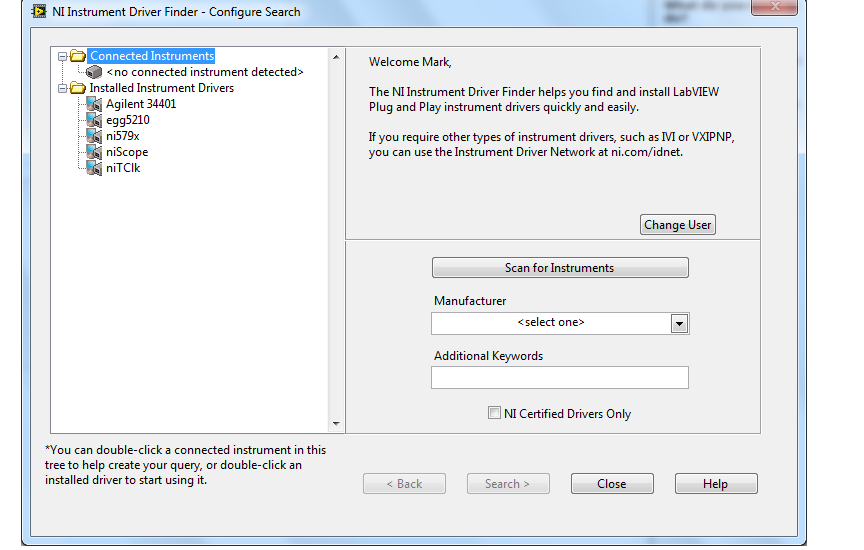

I am New and Unexperienced with Labview, I have a Princeton Applied Research 263A Potentiostat. A rs 232 cable is running from the Potentiostat to a usb port on my computer. I am trying to find instrument drivers for my device, but the computer does not recognize the device.
Any Help at all would be greatly appreciated.

You are not going to be able to use that to find a serial instrument. Just open MAX and verify that you have a new serial port when you connect the cable. After that, you can use the VISA serial functions. I would suggest using a program such as putty/teraterm/MAX to debug before actually writing any code.
(2,734 Views)
MAX won't "find" devices unless it has a driver for it.  For example, plugging in an NI USB-6009 will cause MAX to identify it and tell you the port to which it is attached.  You mention an "RS-232 cable" -- this is (generally) not the same as a USB cable.  According to the Web, this PAR device uses GPIB as its communication medium -- what does your manual say?
