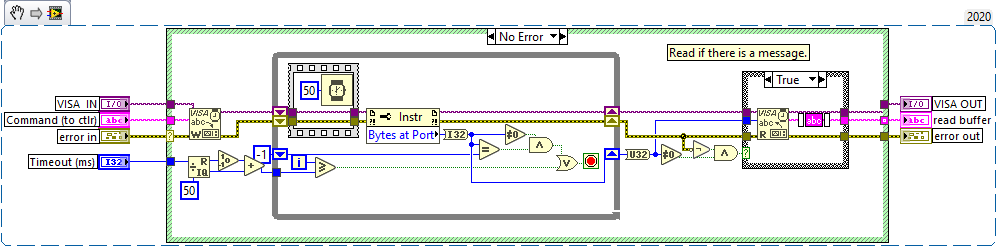

Thank you to @crossrulz for suggesting using Bytes At Port. Because of the "rule" never use Bytes At Port, most people avoid using it for any circumstance, even when it is the best method. Globals, Locals, and Bytes At Port all have their use cases. Yes they can be abused and overused, but there are correct use cases. Personally I believe that Bytes At Port is appropriate for the OP for their use case. (Yes I know I will be down voted for this.) To the OP, turn off Termination characters to use the VI.
Below is an example, 2015 version attached.
mcduff
