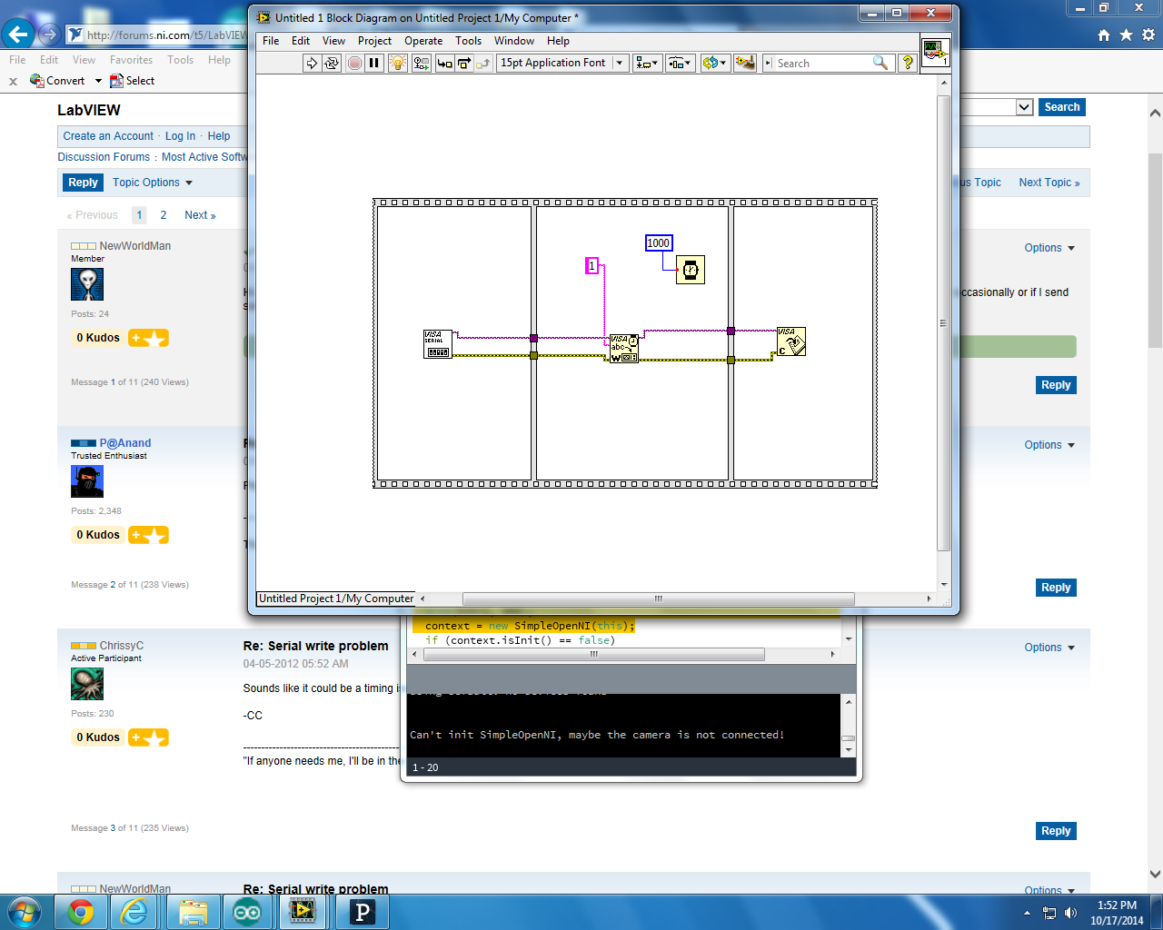

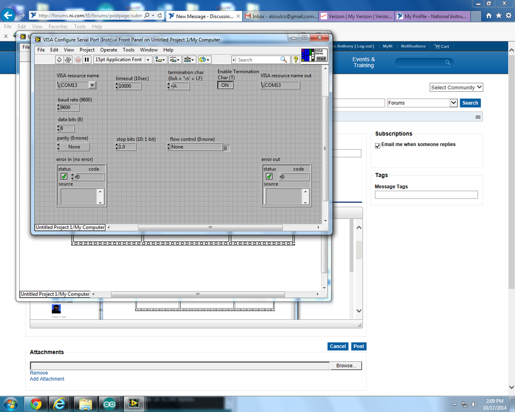

Labview VISo just a little background of what Im trying to do: Make a labview to send a character over to the arduino and the arduino reads that in and then writes to its EEPROM a value if it recieved something. Basically i wrote a simple program to test this out although it only works when I have the debugger active. First I thought this may be a timing issue so I added in a wait paramter but still no luck. Any one know what the solution to getting the program to work using the regluar run  command?
(Also the serial Port does open when in the debugger I know)VI Serial

I have no idea about the arduino code but your block diagram shows that you don't have a VISA Resource Name. It has to be on the block diagram. Opening the function and entering it there does no good.
