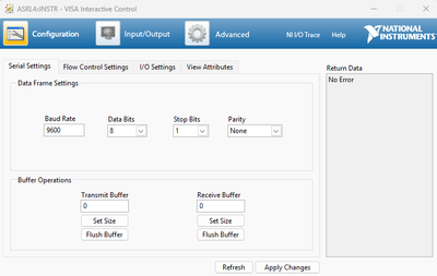

Hello, I have a KERN PCB 2000-1 scale and a KERN-KUP-03 TYKUP-03-A KUP;USB-DEVICE cable. When I communicate with the device using NI MAX / NI-VISA Interactive Control, I have no problem communicating with it. However, with this simple LabVIEW code, there’s no way — I get this error. I’ve already checked the VISA driver installation and they are installed. How can this be? Visa resource name is COM4 in LB and in Interactive panel is ASRL4::INSTR.

Sorry, I don’t understand your response.
I’m only asking because I’m getting a VISA OPEN error, meaning a communication error, even though I’m able to connect in other ways such as NI MAX VISA Interactive Panel and even PuTTY.

Is the COM port occupied by other applications? try to close other applications.
Message 6 of 8
(2,121 Views)
I'll try that, probably fixes it. I'll close the thread. Thank you.
