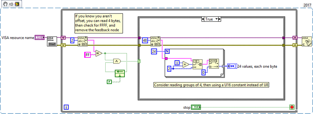

Read two bytes at a time (one byte at a time will just give you F, right?) then check for repeated true comparison.
Here's a simple example:
Some comments are given to show possible alternative choices - for example, if you know you can't be off by a byte, you can read 4 bytes (ASCII, so 2 bytes of binary data) then check directly for FFFF. However, if you might be offset, that could lead to xxFF, FFxx, which wouldn't satisfy the condition.
Message 4 of 11

Can you be sure that the buffer contains the whole phrase? If it is coming in slowly then it could take a while for it to appear there, better to work iteratively.

Now as far as code structure, I have found it best to read 1 byte at a time until you read 0xFF.  Then you read another byte and verify it is also 0xFF.  If verified, read the rest of your message (24 bytes).  Then you can repeat the process from there.  I say to read 1 byte at a time instead of 2 because you could be out of sync by that 1 byte and you will therefore never catch the FFFF.  Using your example, you could read 89FF and then FFF4.  Neither of your two reads would match your FFFF requirement and you miss your entire message.  So read 1 byte at a time to find the sync.
Note 1: Notice the FF constants.  I have those set to be in Hex display.  Right-click on the string constant and choose Visible Items->Display Style.  You should see a little 'n' show up as part of the constant.  That is showing you are in "Normal" display.  You can then click on that 'n' and choose Hex Display.
Note 2: All FALSE cases just pass the VISA Reference and error straight through.
