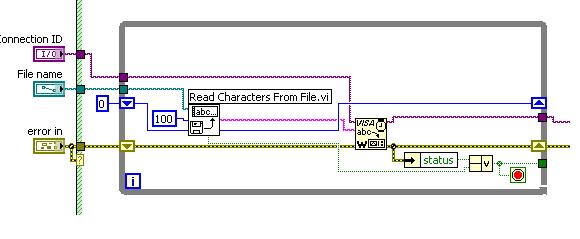

Thanks for your replies and advice.
I used the function in your lib,read charact from file.
Before this, I send a command to the modem stating that I am downloading a file which is xxx size.
This function below then runs, and once the modem received the file, it will reply with OK, and ERROR if there was a prblem
This function(and my previous functions) both work with files I download which are smaller than 7000bytes in size. Modem returns OK and all is good.
When  downloading a file bigger, then modem replies with ERROR.
I am all out of ideas now.

As in the your other post what error are you getting? This simple piece of information is crucial in being able to give advice to resolve your problem. I suspect that you are simply timing out on your data transfer. Either you are not giving the receiver enough time to receive the data or you are not allowing enough time for the response. However, without more specifics it will be impossible to give you better advice.
I would also recommend that you pick on of the threads, either this one or better yet your original one, and use that instead of bouncing between threads for a solution.
