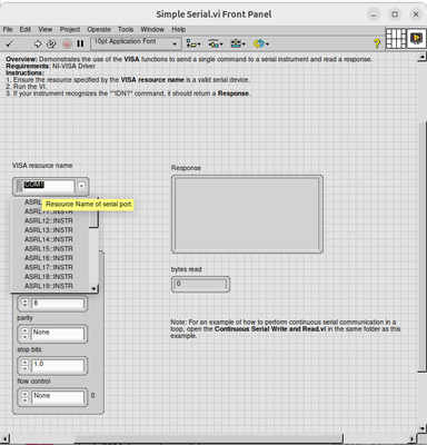

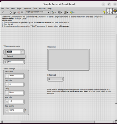

I need to use LabVIEW under Linux, I use LabVIEW 2025 and the OS is Ubuntu 24.04.2 LTS.
I'll need to communicate via a serial port with another module. i installed NI-VISA but when I try to run a LabVIEW example, the enum of the VISA resource name is empty, even if the COM port is plugged and available via the Linux Terminal.
