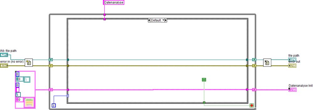

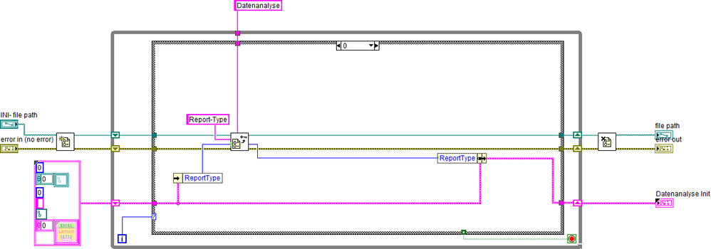

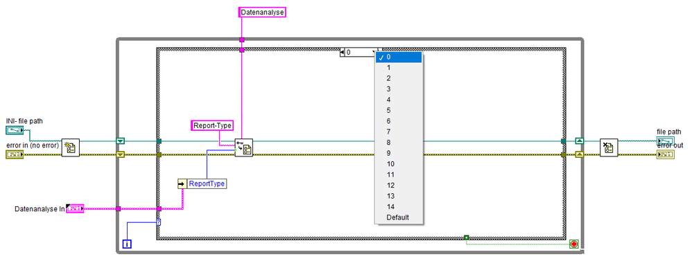

To elaborate this a bit:
With this structure you can set default values in the typedefed cluster constant and wire each value to the "default value" input of the "Read Key" node. You can have as many cases as you want to read every single config-file entry and you can easily expand the number of settings with the "Duplicate Case" instruction of the case-structure context menu.Load Settings (default).png
The while loop is aborted automatically after the last case with the default case. With duplicating one existing case LabVIEW takes care for the numbering of the cases.Store Settings.png
And storing is the same vice versa, so every case in "Read Settings.vi" will have a corresponding case in "Store Settings.vi".

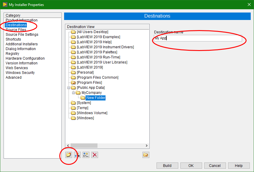

If you want to put your predefined INI file to this public application data folder, you can do this via the installer, as I will show you:
The installer can create the folder on installation time. You define this on this installer panel.

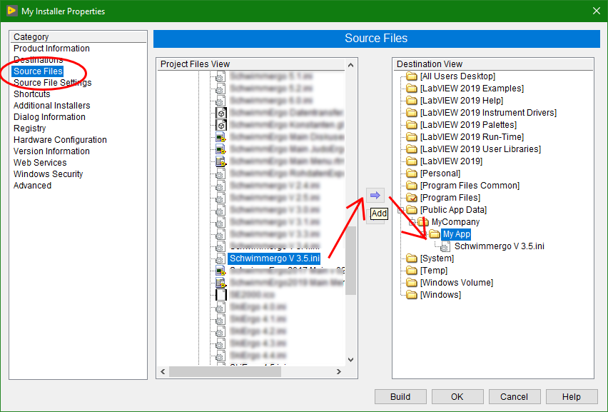

2nd step.
But if you check for the INI file on program initialization and create it from your default cluster if not present, you don't have to bother the installer with this and won't have any issues with an executable which isn't installed, but simply started from whichever location you want.
