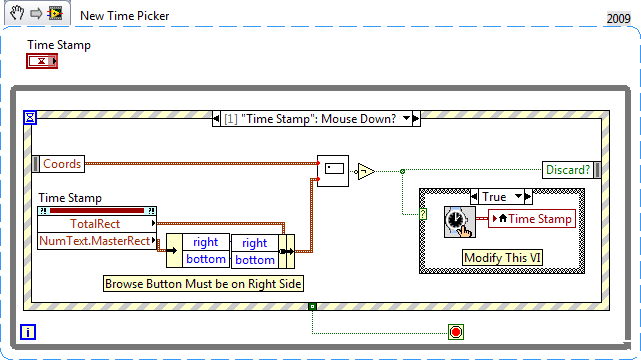

I have intercepted the Browse button on a path control before, this is very similar.  Trap the Mouse Down? events which land inside the time picker button and call your modified VI instead of letting the control handle it.  The simple bounds I find works for the browse button in the default location on the right side of the control (anywhere on the right side in fact).  If you move it to the left hand side, or below, or above you may need to adjust the calculation.  Those blue properties are scripting in case you are wondering.

Thanks, Darin - I've been trying to use your method, but I can't find those timestamp properties or the function that they eventually lead to. I've searched through availible properties, but I can't find them anywhere. Are they standard or do I have to mess with the .ini file for Labview to even see them?

Probably hidden in my previous post, those Blue properties are scripting related.  In LV9 you have to download and activate to use them.

Okay, I installed the scripting development toolkit and I have the extra time stamp properties now. Where can I find the white subVI with a rectangle in the icon? (this is turning into a strange quest of epic proportions by now 😛 spent 1.5 hours on the phone just activating scripting license)

You can actually drag and drop the picture above from an Internet Explorer browser window (won't work in Firefox, to my knowledge) directly onto your block diagram, and all the components you see will be there. To answer you more directly, the VI is PointInRect.vi, found in <vi.lib>\picture\PictureSupport.llb
Edit: I'm referring to NewTimePicker.png above. This feature is called VI Snippets (see the LabVIEW Help). SubVIS are not actually embedded in the .png file, so whatever subVIs are linked need to exist on your disk (such as PictureSupport.llb within vi.lib, in this case).
