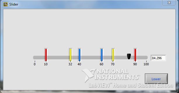

Is there some way to programmatically set individual slider markers to different colors?  I have attached an example front panel showing what I am trying to achieve.  Thanks.

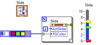

Use a property node in a FOR loop to iterate through all sliders, autoindexing over an array of colors.
(Note that the second property is "slider Colors:FG color" )
(5,725 Views)
Thanks for your reply.  Your solution changes the slider color.  I need to change the scale MARKER colors similar to the JPG file I have attached.  I see no way to select on an individual marker and specify its color (e.g. set marker "8 -" to red).
Looking again at your picture, it seems that these values are static and pairwise define ranges. You probably could even hide the added sliders and play with the fill color.
Or you could even just play with decorations.
(5,659 Views)
My solution uses 6 vertical sliders, with sliders and markers hidden, that are programmatically colored and positioned over the desired horizontal marker locations at runtime.  The desired marker locations and colors vary from run to run.  For technical reasons, my solution does not work for the general case.  So using one horizontal slider with multiple active sliders as markers seems like a good solution.  I have not tried the idea so I will update this post with the result when I am done.
