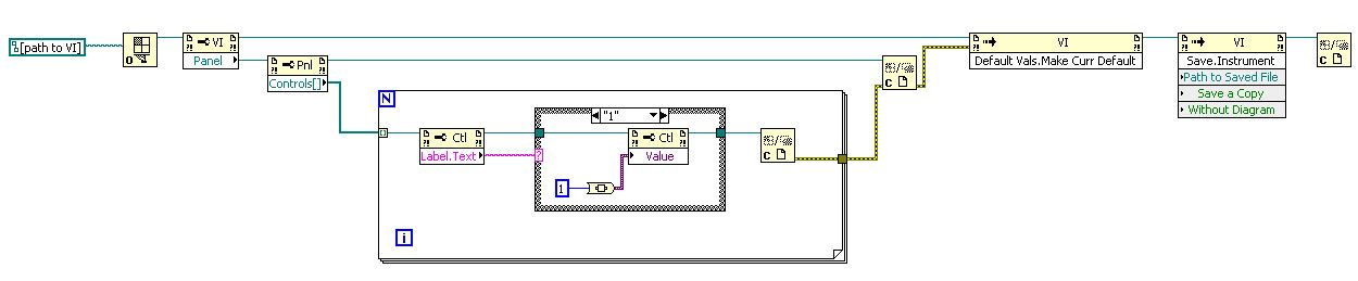

Have you tried using property nodes to set the values and then method nodes to "make current default" and save the VI?
Message 4 of 11
(11,004 Views)
That worked!!  You rule.  I had to add an error handler because I kept getting an error message from the Set Values as Default block saying that the target VI was not in edit mode, even though it was.  Anyway it set the control default values successfully so I just ignore the error.  Thanks for the help!

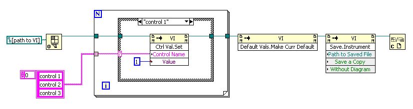

Not sure why you would be getting that error, but I'm glad it's working for you. And since we're on the subject, a simpler alternative way is to use the Ctrl Val.Set method:
