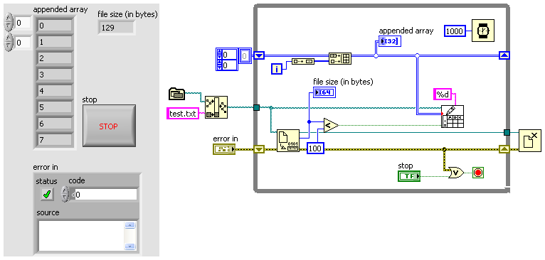

you may be using this function incorrectly?
this example 'gets file size' and compares it to the size I want(100 bytes), then bools to the append file terminal of 'write to spreadsheet'...as long as my file is less than, append information . otherwise new file if more than  Smiley Wink

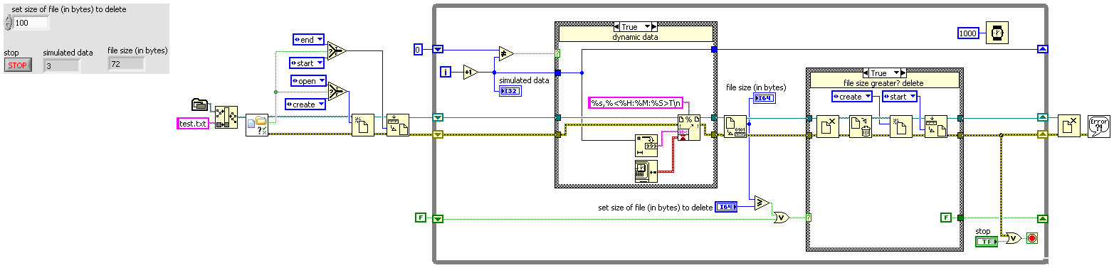

  • build path 'test.txt'. check if it exists?
  • yes, open file and set file position at end or no, create file and set pos. at start.
  • put simulated data on SR and not equal compare from previous iteration,T then write data and time, F then do nothing
  • check file size and compare to user set size....less than,do nothing and for greater than, delete file and create new one with file pos. at start
  • loops stops on error
  • stop loop and close file reference
