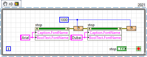

How about something like this? 
You will need to create Property Nodes for every control and indicator.

Sure this works for that control.
What I should have mentioned from the start:
I want to do this with hundreds of controls, ideally without having to know the type of the control.
(1,806 Views)
Yes, you just make an array of all of the references you want, then feed them to a For loop with a property node that sets the font.
If you don't want to generate that array manually, you can open a reference to the front panel and get all of the objects in it. If you only want to set all of the, say, Boolean controls, then use a To More Specific Class to try casting it to a Boolean control refnum. If that errors, then it's not a boolean, so ignore it. If it works, then set the fonts.
