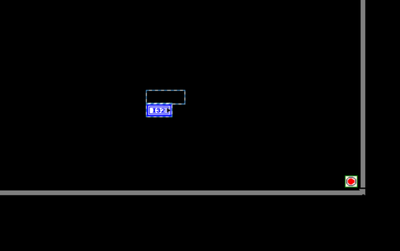

How can I change the default color of label text to white... or any color?  I've changed my block diagram color to black and of course cannot see any label text.

Uncheck "use transparent labels" for the block diagram options.
(Still, I strongly suggest to stick with the default block diagram colors. Any background other than white will make certain wires and objects much harder to see! Really bad idea! The block diagram is for the programmer and does not need to compete in any beauty competition.)
