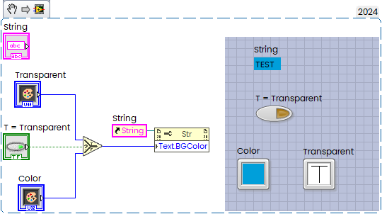

Hi Andrey_Dmitriev,
Thank you for your answer. I tried your solution, but it doesn't work. I can change the background color to transparent, but to get a real transparent indicator, the frame if the indicator needs to be changed as well.
The only way that I found to do this is to use the tools palette and change manually the color of the frame.
This is what I get with your example
And this is what I want:
Thank you in advance for your support!

@Gub156 wrote:
Hi Andrey_Dmitriev,
Thank you for your answer. I tried your solution, but it doesn't work. I can change the background color to transparent, but to get a real transparent indicator, the frame if the indicator needs to be changed as well...
Why do not use Simple Text indicator from Classic Palette:
You can easily make it "frameless" (see my attachment in previous comment)?
