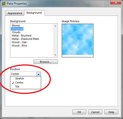

The horizontal and vertical scroll bars move the controls... but the background image doesn't track.
When select the background image, set the Position to either Stretch or Tile, instead of Center.

That was tried.  First placed the image, set Center, back to the front panel, started placing controls... and nudged the scroll bars.
The controls tracked the scroll bars.  The image stayed put.
On my pane properties panel, the Stretch/Center/Tile is at the right.  Perhaps we're using different versions of LV ?
