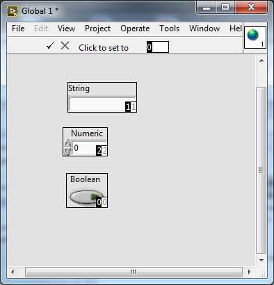

If you go to the global front panel edit menu and select "Set tabbing order', the control set to tab order 0 is the one that will display when you drop the global on the block diagram. But if you click on the global it will not display the different possible controls in the tabbing order. It looks like it uses control labels alphanumerical order (number preceeding capital preceeding lowercase).

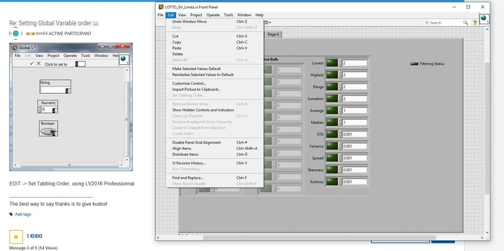

EDIT -> Set Tabbing Order, using LV2016 Professionnal

In your example the "Edit" is grayed out.  What exact Menu Control path got you to this edit window?
Message 9 of 12
(5,427 Views)
Here is a screen Capture of my Global Variable Tabbing Order.  Under Edit -> Tabbing Order is grayed out
Why:
2017-09-16  LabView Global Variable Tabing Order.jpg2017-09-16 LabView Global Variable Tabing Order.jpg
