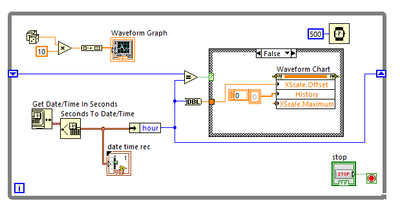

Can anyone share a tip for how to get the x axis to go from 06:00 to 23:00 and than on to 0:00 and 06:00? (Appending a picture of the loop I'm using for testing.)

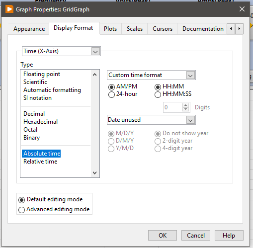

  4. Go to the Display Format property of the Graph.  You need "Absolute Time" (since you want "actual", not "relative", time).  Choose HH:MM, with AM/PM and set Date as "Unused".
  5. You need a "Custom Time Format", so check "Advanced Editing Mode".  In the Format String, remove the part that shows the Date (on a second line).  The Format should be %<%I:%M %p>T which means 12-hour Hour, colon, Minute, space, AM/PM in Absolute Time format.
  6. Go look at your Graph.  You should now see time starting as some "number of hours" (mine shows 7 P.M., because I'm on the Eastern part of the US)(extra points for figuring out why 7 PM), and ends just after 7:16 PM.

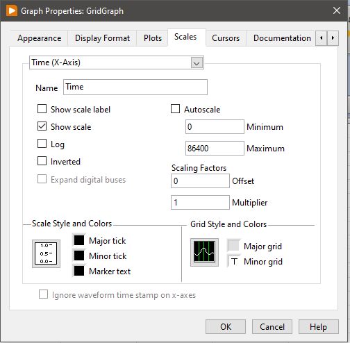

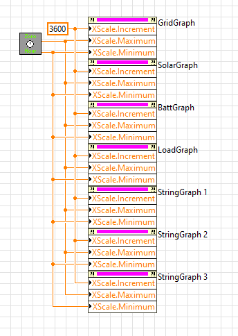

Here is what I did for tracking daily solar production:
I set my X- axis properties like this:
86400 is the number of seconds in one day

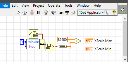

When I launch my program and every night at Midnight I clear the graphs and set their X axis min and max to 12:00AM to 12:00AM with the attached ZeroHour vi.
I also set the X axis increment to 1 hour (3600 seconds)
