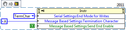

so the first layers are OK , its a layer 7 or 8 problem 😉
you found out that the querry command of your driver didn't work because of the missing termination character.
one possibility is to add this in every command send , or have the VISA driver do it for you.
After serial int set some more properties:
the termination character to \n
and the
Serial Settings:End Mode for Writes
Short name: ASRL End Out
Requires: Base Package
Classes: Instr, Serial Instr
Specifies the method used to terminate write operations. Valid values include: (0) None, (1) Last Bit, (2) TermChar, (3) Break. The default is (0) None.
Descriptions
(0) None—The write will transmit the exact contents of the user buffer, without modifying it and without appending anything to the data.
(1) Last Bit—The write will send all but the last character with the highest bit clear and then transmit the last character with the highest bit set.
(2) TermChar—The write will send the character specified as Termination Character after the data transmits.
(3) Break—The write will transmit a break after all the characters for the write have sent.
here what I suggest to try:

Hi Henrik,
Thanks for being so helpful. I am still receiving an error with that configuration please find attached a picture of the program as it stands now. Do i need to set my power supply to local or remote serially in the basic serial write or read.vi first before i perform the *IDN?\n command.
