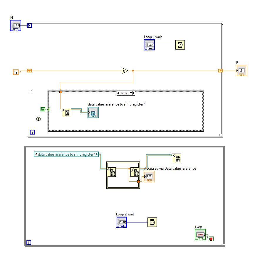

Crossrulz, how would I code a Data Value Reference if I like to keep my shift register? The quick tests I just did suggested I need to make a new reference for each round in the main loop, and somehow transfer that reference to the other loop.
Ola
This vi does not work at all...
Message 7 of 10
(5,581 Views)
You need to create the DVR before both loops and pass the reference into the loops.
Message 8 of 10
(5,575 Views)
I understand the simple example, and is there a way to use a similar approach to read data that is stored in a large shift register?
Message 9 of 10
(5,567 Views)
Just make sure the data type of the DVR matches that of the shift register and it will work exactly the same way.
