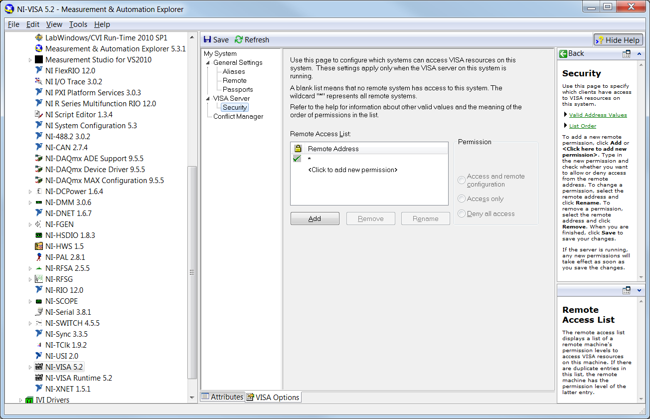

Also, check your VISA settings in Measurement and Automation to allow any remote system to access the host computer. Expand the software and select NI-VISA (version number). On the right, select the VISA options tab. Add "*" to allow all remote systems to access the host computer. You should do this for your remote system as well. See below:
