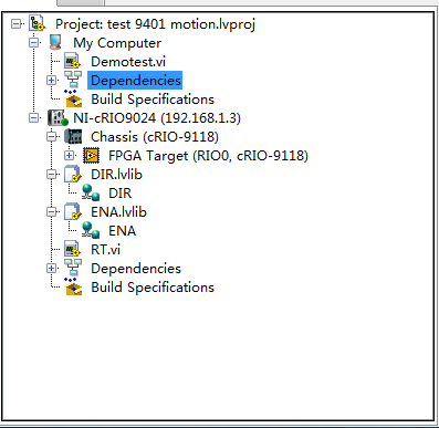

OK! I will post it!  I set two shared variables in program of cRIO9024, and I use the shared variables to get the datas form Demotest vi on PC.
this is part of  Demotest.vi. you can see I add a delay function ,then it works well. but actually I do not know the real reason!
