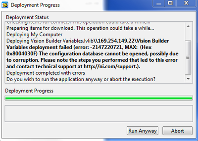

This is the error that keeps appearing when I try to deploy variables different ways. What I have tried is opening Measurements and Automation Explorer and repair the software but that also did not do anything. I am sort of stump on what is causing the error. Thanks for the suggestions though.

ClaytonFromEdge,
Have you tried resetting the database, or running the MAX Database Corruption Removal Tool? The error itself indicates a MAX database corruption, so I would start with those two steps first.

lagelian,
Resetting the configuration data worked! I got the executable running and it says it deploys all the variables. But the variables still don't appear in the DSM and they are not communicating with VBAI. None of the indicators in the executable update the new images or calculations from VBAI. Is there something I am missing that is preventing the variables to be deployed to DSM besides the firewall and build specs for the executable?
