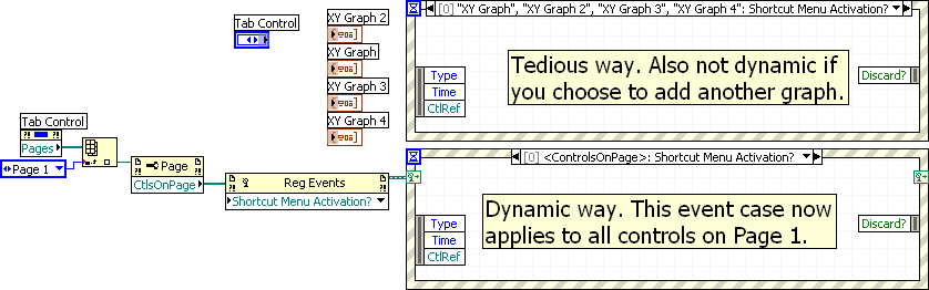

There is indeed a more generic way to register for events, especially if all the controls you want to register events for are on a particular tab page or set of tab pages. You can dynamically register events using the Register for Events node in the User Events palette (it's moved around from LV7.1 to 8.x, so search for it).
As seen in the pic below, you can wire in an array of references for controls and select the event to register in this node. It outputs an Event Registration Refnum (try saying that 10 times in a row). You can wire this refnum into the Dynamic Events Terminal of the Event Structure. You don't see this terminal by default. You have to click the Event Structure frame and select Show Dynamic Events Terminal. After wiring it in, you'll be able to select your new dynamic event for an Event Structure case.
And voila! Any number of controls have registered events without any tedious navigation of the Configure Events dialog! This technique is also very useful for dynamically unregistering events when they're no longer needed, and of course for registering for User Events, which are data-only events that aren't bound to front panel controls. Search the site for User Events for more info on how to use all this stuff.

Oops, the screenshot didn't come out just right. Note that the control reference array from the CtrlsOnPage property node should appear to be wired into the Shortcut Menu Activation terminal, not one of those upper terminals.

Great post Jarrod, I've been meaning to figure out Dynamic Events and your example helped a ton. I attached a screen shot of what I did to loop through each page and get the control refnum of the graph on each tab page. It assumes there is one graph per page. Works great.!
