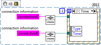

Great!!! found that i can save some 300 - 800ms if i keep the connection open.
