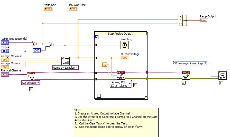

I am trying to create a vi that will allow the user to adjust the values to create a ramped array and show it on a graph.  Then when the user presses a start button the actual output is displayed on top of the calculated plot.
Eventually the user will be able to chose between and input a csv file with captured data from an operation instead or use the rampgenerator.vi.
I have tried many variations over the last couple of days.  I am not sure what the correct approach is.  Just a couple of weeks ago I completed LabVIEW Core 2 and feel I am over complicating things.RampGenerator-AO.JPG

David,
For the user choice you will want to implement a case structure or even a simple state machine.  You can look at how the simple state machine works by opening a new project from template.  There is a state machine option as one of the templates.
What specifically are you having trouble with currently?  There are a few different pieces to this and it would be helpful to know what you need the advice on.

Thanks for the Reply Jon,
I just placed two xy graphs on top of each other.  Then populated one graph before going into a while loop.  I discovered how to do this on the dyno example vi.
